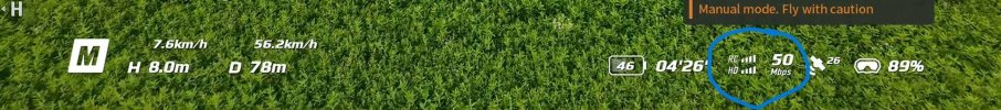

1: I don´t know what´s too far, too high is 10m in manual mode, when the Neo switches back to normal mode. I descend beiow 10m, turn it back to sport mode and again to manual and fly on.
2: Not always RTH, it depends on your security settings RTH, hover or land. Never happened to me, that I flew out of range. Regarding YT videos the drone will fly away. There are however values to watch: the bitrate of the video transmission and the signal bars. This is max 50Mbps.
The less the Mbps, the weaker the signal. At some point the bottom of the feed turns to orange, then red. In this case turn back or ascend.
I use the ham file on the goggles, that turns on FCC/HAM mode, which has strong transmission power and there are 2 options: auto or manual. I always use manual 2,4Ghz, because it has much better penetration and range, than the 5.8Ghz.
3. I opened the propeller topic a year ago, since then I try out new propellers. The Neo is a regular 2 inch ducted whoop, with 1,5mm shaft. It means that, almost all 2 inch T mount propellers can be put on. Some open propellers won´t work, because the arms block the tip of the propeller. Other things to watch: the original propeller has a 1,6 inch pitch. Not recommended putting on props with much higher (overprop) or lower values. I personally use the GemFan hurricane, this has a 2,3" pitch or the HQ Tr2022 4 blades, this has 2,2" pitch, but 2030, 2035 or above are not recommended. You can use the infamous D51 GemFan props, but I can´t recommend the 5 blade, because it has a big drag -> battery drain. The 4 blade version is fine. If you decide to put on 3rd party props you´ll need M1,2 x 6/7mm metric screws and 1,2mm x 3mm (or similar size 1,4mm is okay) washers. What I can recommend is the HQ2x1.6x3-Neo props. This is a Neo spec prop, original screws can be used. Similar performance and sound to the OEM.

Hey @Christian, thanks for the detailed response.
I really like your suggestion on the HAM files. Will try that out.
As per the propellers; I will study your suggestion carefully and report back with experiments when I do them.
